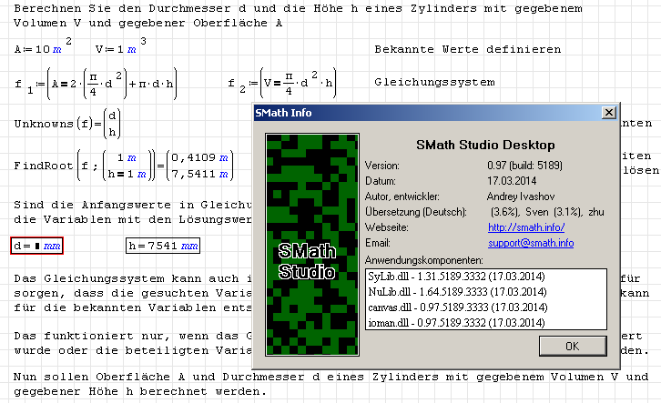

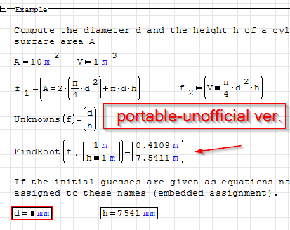

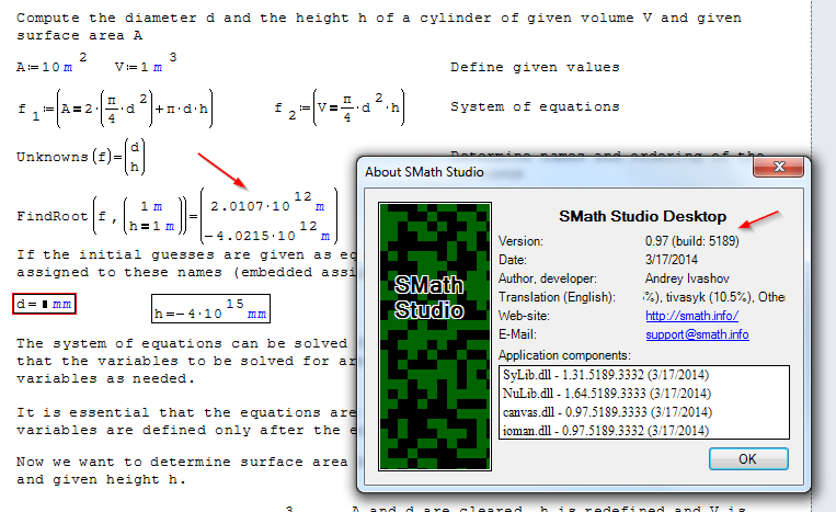

By the way Martin,
I might missed it, but I think there is still no answer about the differences between the official (wrong) and unofficial-portable (correct) and FindRoot() example

#6 Posted: 5/3/2014 9:31:29 AM
This is quite strange . Could someone else else try to reproduce this please.
This is only happening to me with the official (regular) install

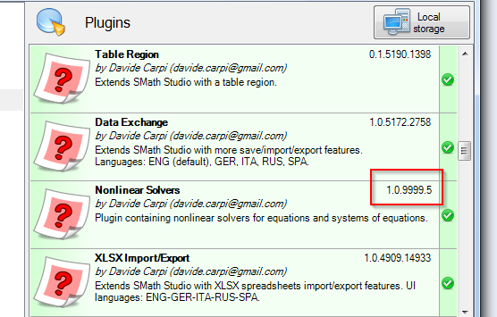

NS version is 1.0.9999.5 for both of you (Martin and Radovan)?
Hello Davide,
I also confirm the plugin version - see the picture please.
BTW, this is the same on my both computers home-Win7 32bit, office-Win7 64bit
