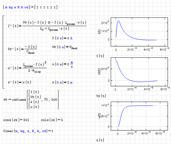

Hello SMATH Collaboratory,
I attempt to convert a Prime sheet to SMATH. The Prime sheet uses a solve block with "Odesolve" (pdf attached). I tried using "ODE2" but I do not have Maxima installed.
Is there another route?
I welcome your review and look forward to your replies.
Sincerely,
Norm

Hi. You can try this. Even this returns functions for I(t), Vr(t) ... there is a unit issue. But you can use the values in rk with cinterp for reconstruct the functions with units.

Awesome! Thank you, for your help!
