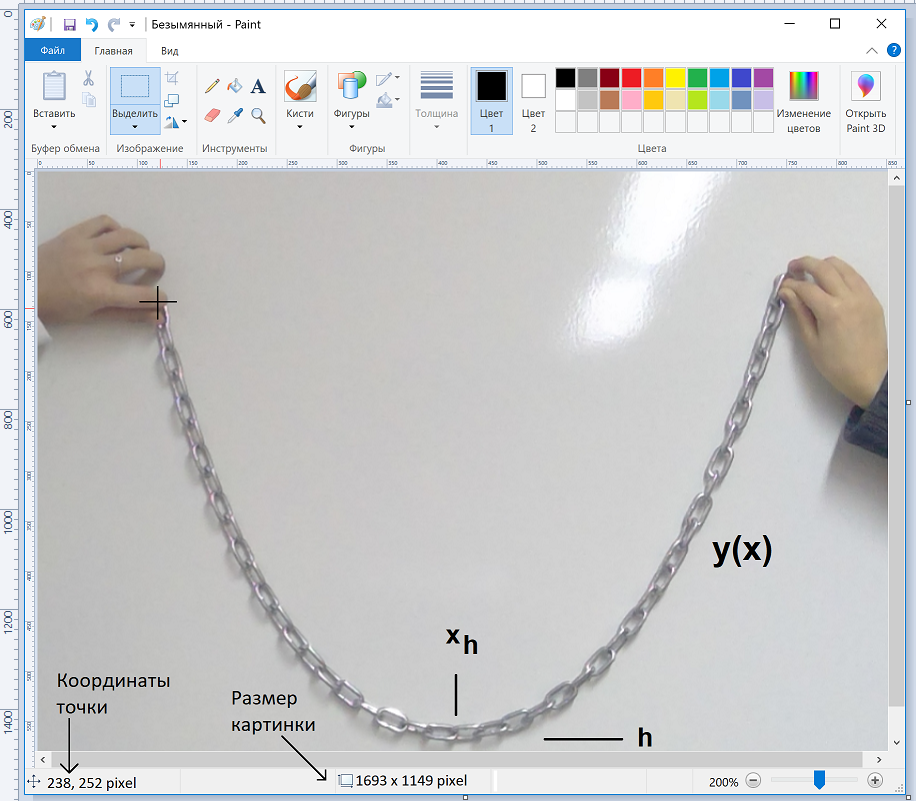

How to use here the al_nl plugin?
Catenary-Photo-an_nl.sm (1.2 MiB) downloaded 1681 time(s).

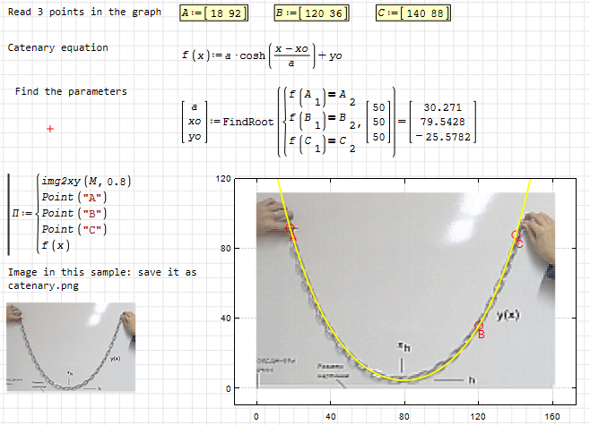

Hi Valery. You can try this.
img2xy-catenary.sm (2.19 MiB) downloaded 1662 time(s).

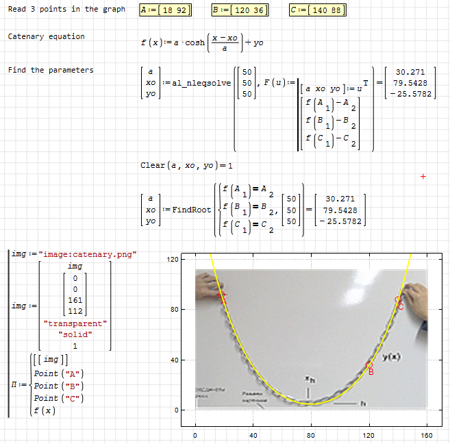

... the question was not about y(X), but al_nl****
Hi. Using the new functionality of XYPlot:
Image with size 161x112:
Smath file: img-catenary-al_nleqsolve.sm (19.15 KiB) downloaded 1520 time(s).
