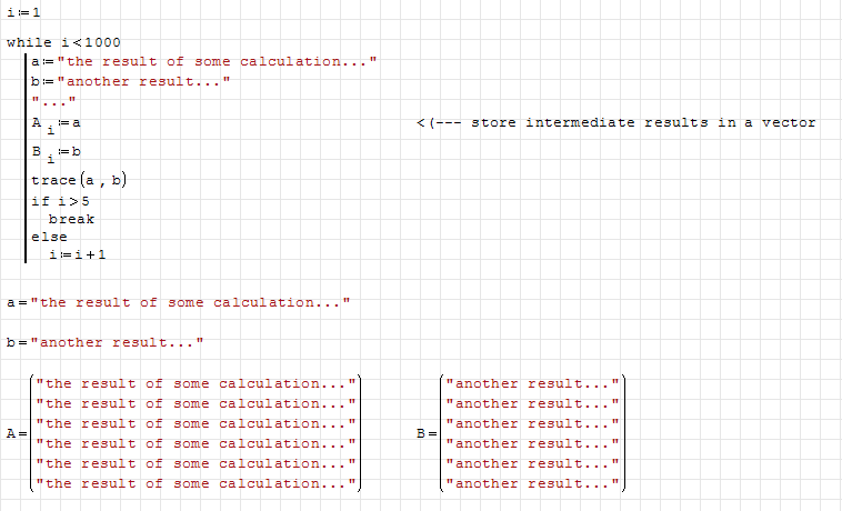

Hello cartographer,
If you don't need to store intermediate results, you can use a standard while loop like the attached.
trace() function (wiki:trace) in this case helps a lot to debug.
In the other hand, if you need the collection of the values at any loop, you can use vectors/matrices to store the results.
Best regards,
Davide
P.S. Use numeric optimization to speed up calculations
![2014-07-21 15_56_27-SMath Studio Desktop - [while.sm_].png](/en-US/files/Download/6y8zmX/2014-07-21-15_56_27-SMath-Studio-Desktop---[while.sm_].png)
Best regards,
Davide
