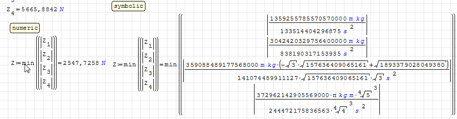

I have a small problem calculating a variable within a routine, that has worked before, but doesn't now..
Error is "units don't match".
When I look at the variables, the units are all the same.. don't see how I can trick the program into believing the this…

The issue is related to the symbolic optimization. Switch the optimization of the definition to numeric to solve the issue.
