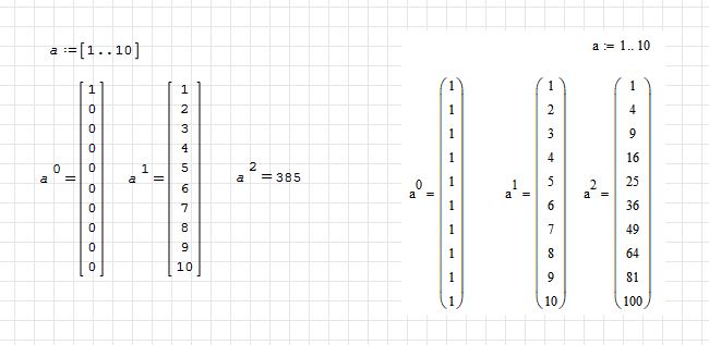

How can I equate power of range to the following? How can we solve this error, anything power should be 1.
When a range is square, the return answer is total of square value.
As you evaluate over a vector, use the vectorize operator.

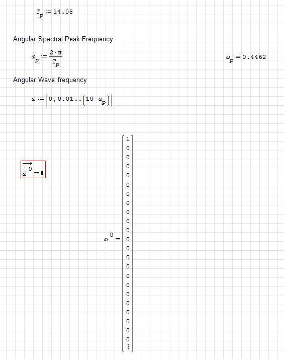

I tried to vectorize the following. What have I done wrong?
Hi. There the problem is 0^0, it is undefined, at least in SMath environment, and probably it's the best choice: return an error if appear. That for the vectorization. About w^0, without vectorization, seems that SMath try to do a scalar product, like in w^2. Remember that a^0 = 1 for a <> 0 it's by definition, not by any theorem.
