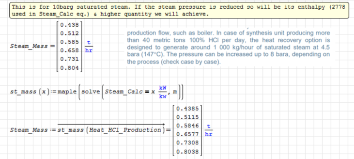

I want to using solve function for a simple arithmetic equation. But one of the value is an array so I must have array of answers. I am unable to achieve this using solve & maple.solve
As the last resort I had to solve the equation separately which is both boring & not dynamic. The equation has units...

#3 Posted: 11/17/2020 7:14:29 AM
usamakhan
usamakhan
7 likes in 97 posts.
Thanks for the solution. Can you please explain why we need to vectorize (above arrow) the last statement?
Secondly I cannot add units to x in the function developed st_mass? My version is 0.99 (6671)
#4 Posted: 11/17/2020 7:20:34 AM
1,558 likes in 1,868 posts.
If the function uses a scalar and you substitute a vector of values, then you need to either use a loop over the elements of the vector, or the vectorization operator.
Try to multiply x by 1 and replace 1 with units.
And I think that the maple() function is not needed here, an ordinary solve() should handle it.

Per my experience maple.solve handles units far better... However still I am not able to reproduce your results.
Sheet is attached, may be my version is old?
Page1.sm (174.42 KiB) downloaded 1445 time(s).
#6 Posted: 11/17/2020 8:29:19 AM
Keep in mind that the function maple() doesn't know anything about units at all. The function uses a special trick to ignore them in its work.
Try now
Page1 (uni).sm (175.19 KiB) downloaded 1379 time(s).
Page1 (uni).pdf (380.33 KiB) downloaded 911 time(s).

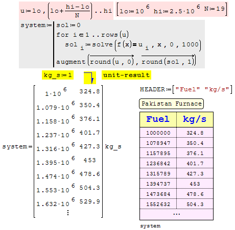

Here is Engineer style ... no need for Maple, just native Smath
Attached SS 6179 ... some volunteer to make it unit kg/s
Ioncube Otherwise.sm (20.16 KiB) downloaded 1210 time(s).
Hi. I guess that the problem is that kw just like "kw" both in lowercase isn't an unit, but it is kW. To know the name of an unit you have the coup icon for insert one in the toolbar.
In the attached using kW instead kw, maple don't needs units manipulation, but SMath's roots needs.
Page1 (uni).pdf (413.26 KiB) downloaded 877 time(s).
Page1 (uni).sm (177.25 KiB) downloaded 1421 time(s).

... forget units, reconciliate as you wish in the solve bloc & Table
Ioncube Otherwise.sm (28.65 KiB) downloaded 1182 time(s).
