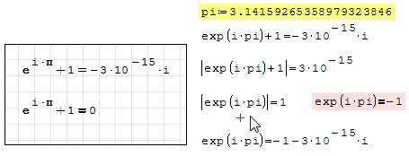

This is maybe not a bug but it doesn't look very well.
Result should be pure real 1
I understand why this happen and wonder if that fixable

1. your expression is incorrect: Euler 'e' is a number
2. as it should be '1' but not computable it displays complex.
3. often, annoying but |abs| makes it computed.
4. some ancient MainFrames still have pi in numerical values [XXX decimals]
5. Advanced computing machinery use "Simon Plouffle".
6. NOT a bug: just a fact not yet fixable [expect more from Smath Geeks].

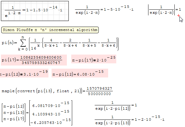

#3 Posted: 10/28/2018 9:46:08 PM
The search for 'pi' exhausted great Mathematicians [Legendre ...] not to avail.
The proof to 'pi' by isoperimetres dates back to 1813 by French Geometre "Schwab"
Simon Plouffe limit of 'n = infinity'

Hi Kriss. You're right. It's a shame that the result isn't exact.
This was call the most beautiful equation, because relates the most important numbers in the history, which came from different disciplines: calculus, geometry, complexes and natural numbers.
#5 Posted: 10/29/2018 11:40:50 AM
Even worst if not cautious !
Annoying in the attached LinfitCheby.
Was reported long time ago.
GenfitLinfitCheby.sm (74.75 KiB) downloaded 1275 time(s).

Thank you! Fixed in the latest beta: https://en.smath.info/forum/yaf_postst14958_Beta--SMath-Studio-0-99-6877--30-October-2018.aspx

Seems to be working. Thanks
