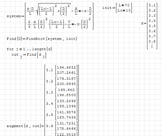

This solve block does not accept iterative scan.
Can't make it work YET ! for multiple solutions.

I guess is not possible (?) with current version, one reason (but not the only) is because embedded assignments.
Will works with the refactored version, though.

Thanks Davide,
In the mean time: I did, a bit differently.
Next => collect for the plot.
