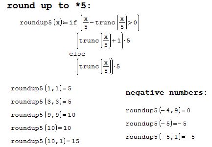

#3 Posted: 5/23/2017 6:10:52 PM
Hello Destory,
Apart from the Ceil function, you can write your own function for this, i have made an example for you:
you can edit the function (extra if loop) if you want it to handle negative numbers differently.
ceil_and_roundup_to_5.sm (7.7 KiB) downloaded 2031 time(s).
I hope this helps you.
regards,
csb
regards,
csb
