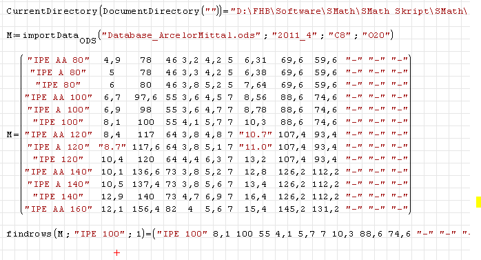

#2 Posted: 11/6/2013 5:58:59 AM
#3 Posted: 11/11/2013 1:46:55 PM
Thank you martin. You have been very helpful.

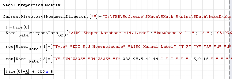

Do you think this excel file is too big? I was not able to reach the end of the calculation time.
See attached
