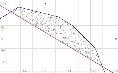

#7 Posted: 9/30/2019 7:04:59 PM
dio pants
dio pants
16 likes in 180 posts.
Jean Giraud-
but how do you set your graph axis to -100
that is what i was trying to fix to hard values so it would not move or rescale the graph
sinneD

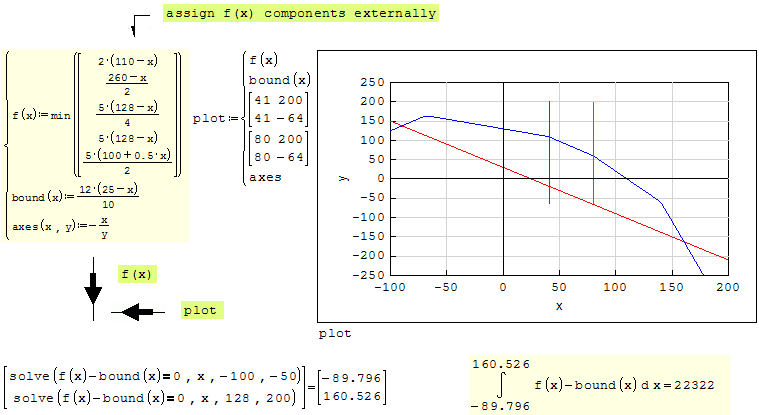

#8 Posted: 10/1/2019 8:35:03 AM
1. Dispose the plot from plotting using Smath @ QuickPlot
zoom, shift left/right, up/down ...
2. Plot on the X_Y, set the X ± limits, Y ± limits.
3. plot ... 4. specify the traces from "list"
As simple as explained, no sweat ! ... Last plot.
2D Plot Discontinuous [min(,)].sm (44.49 KiB) downloaded 1053 time(s).
