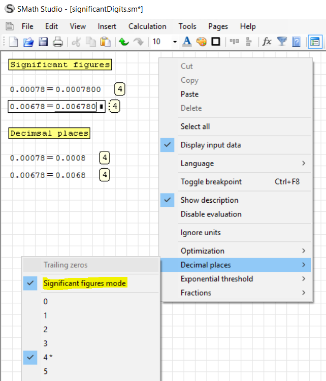

Hello all.
I'm about to introduce Significant figures mode for numeric results.
The question is: it is logical enough to implement such a UI? So that Significant figures mode is located under Decimal places...
For me it looks very convenient (the one who want to tune accuracy will definitely open Decimal places menu + there is no need to have separate menu level), but what do you think?
Best regards, Andrey Ivashov.

I was just thinking about this today! I'm glad to hear you're implementing this functionality.
I think the decimal places menu is a logical place to put the option.
Will there be an option from the toobar menu as well? Tools -> Options -> Calculation to make Significant Figures mode default?

Thank you!
Yes, exactly in the place you have mentioned.
WroteWill there be an option from the toobar menu as well? Tools -> Options -> Calculation to make Significant Figures mode default?
