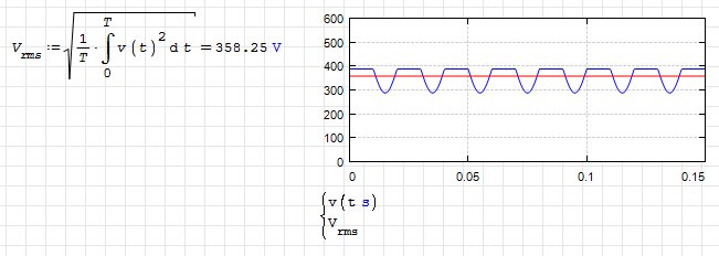

Dear Friends,
I tried to calculate the effective value of segmented voltage waveform, but failed, could you help me to fixed it? Thank you very mucn! RMS calc.sm (10.21 KiB) downloaded 928 time(s). image.png

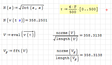

Hi. This is a way. You can see also the file RMS in this post.
Also:
RMS-example.sm (17.81 KiB) downloaded 860 time(s).

Version without killing the units:
RMS-example.sm (8.29 KiB) downloaded 861 time(s).
In the original version, just making the periodicity function unit-proof, is sufficient:
