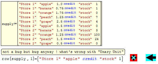

#1 Posted: 3/6/2018 11:15:32 AM
No logic in that observation.
How can I explain if I can't explain to myself ?
Utilities Matrix [Parse Lookup, Truth Table].sm (26.37 KiB) downloaded 1130 time(s).

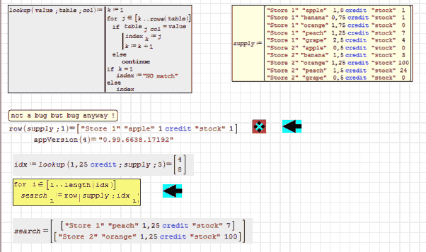

#3 Posted: 3/6/2018 1:47:03 PM
The 1 in results with units was suppressed in SMath Studio 0.98.5935 (there is even a comment by Mike in that thread about this behavior) and doesn't apply anymore at least since the version 0.98.6606 (talking just about stable versions)
right now I cannot find if this was fixed intentionally or not, however it seems is no more an issue currently
![2018-03-06 17_42_20-SMath Studio 0.98.6606 - [Utilities%20Matrix%20[Parse%20Lookup,%20Truth%20Table].png](/en-US/files/Download/gnKk5o/2018-03-06-17_42_20-SMath-Studio-0.98.6606---[Utilities%20Matrix%20[Parse%20Lookup,%20Truth%20Table].png)
