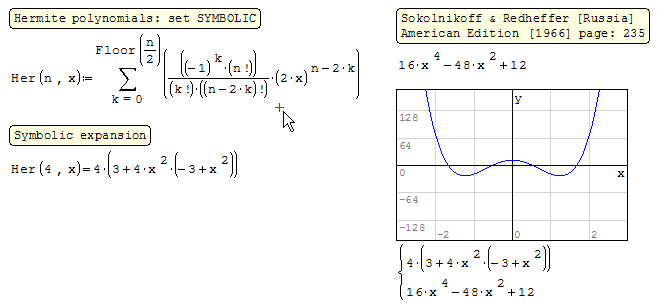

The Hermite formula is totally correct. Here the sanity with my bible.
What's lovely with Smath 5346, at opening a work sheet it defaults to
symbolic. Thus, compose the formula, up it plots and resumes the
remaining of the project.
