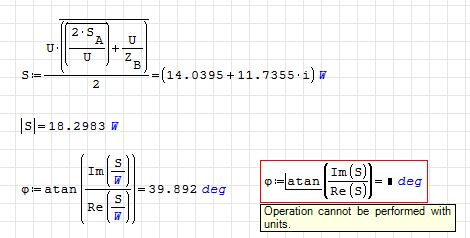

Any solution to this units problem?
Thanks,
Basile

I've corrected Im/Re functions to support units. Will be available in the next nightly build.

Use the function arg(complex)

Andrey and Jean,
Thank you very much,
Basile

It looks that it still in the xy2pol
