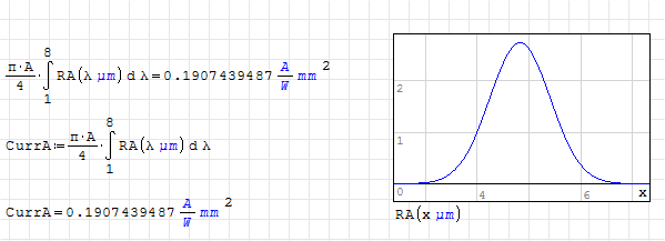

#4 Posted: 1/8/2013 12:59:36 PM
Thank you very much for your answer,
I've attached a file that's explaining the error that I get.

#5 Posted: 1/8/2013 1:14:02 PM
#6 Posted: 1/8/2013 2:42:35 PM
Good point:
If your function involves units you must specify units on the independent variables when calling the function.
Edit:
Anyway on my sample the integral seems problematic dealing with units, since it should return square meters.
Edit2:
Sorry for the confussion, the integral works fine here!
I wanted to assign units to the result taking into account the geometrical interpretation of line integral, similarly Callmeishmael referred to units for the physical meaning of velocity.
Edit:
Edit2:

#7 Posted: 1/9/2013 5:03:04 AM
Thank you very much for your suggestions: now the formula is working correctly.

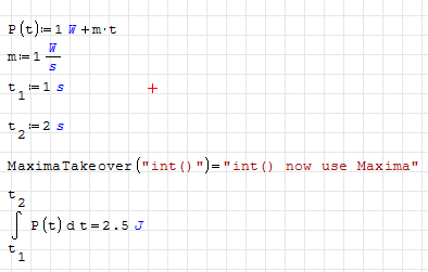

#8 Posted: 11/12/2014 3:02:20 PM
WroteGood point:
I don't understand. If you have a constant power dissipation of 1 W for 1 second, you will consume 1 J of energy. To write this in integral form: [see attached image]
int(1 W, dt, 1 sec, 2 sec) should equal 1 W * (2 sec - 1 sec) = 1 J
So why can't we use units in the limits of the integral?

#10 Posted: 11/12/2014 5:13:44 PM
So you're basically removing the units before the integral and then re-adding them after it's done? What does LE stand for and why is it blue like a unit for you? It's not for me.
#11 Posted: 11/13/2014 3:32:05 AM
#12 Posted: 11/13/2014 12:33:13 PM
..assuming you have the Maxima plugin installed and Maxima installed?
