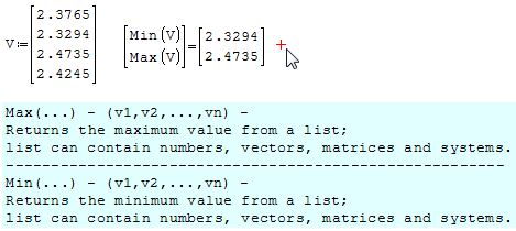

#5 Posted: 1/29/2018 8:02:40 PM
More generally:
#6 Posted: 1/29/2018 8:13:54 PM
Min/min ... Max/max are 2/4 different animals.
2D Plot Discontinuous [min(,)].sm (13.56 KiB) downloaded 1023 time(s).
