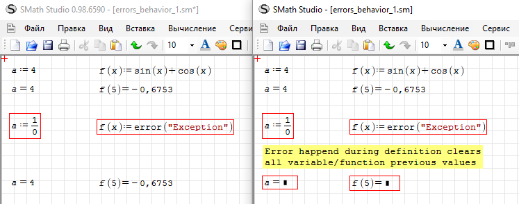

Almost forgot to highlight the following important change done in this release:
errors_behavior_1.sm (4.43 KiB) downloaded 2221 time(s).

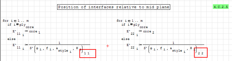

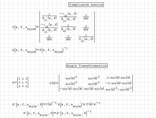

Hi Andrey
Very surprised that an error popped up in the latest build. Maybe also the one before, not sure.
For your info, here is the S' definition
It seems that somehow these last two builds cannot find a value of the matrix coordinates indicated. It worked fine in .6484 from October, which I have gone back to. I can send you the file, but I would prefer to do so privately.
Love this program
Doug Schickler

#6 Posted: 3/7/2018 11:59:51 PM
It seems that somehow these last two builds cannot find a value of the matrix coordinates indicated.It worked fine in .6484 from October, which I have gone back to.I can send you the file, but I would prefer to do so privately.
That it worked 6484, I doubt as it shows incorrectly dressed.
If you had a result => most probably erroneous.
On the setup "rotation*matrix", Smath [4356, 6179] displays an error message.
The rule Matrix*Rotation is universal, not commutative.
UnknownConfidential.sm (202.5 KiB) downloaded 2172 time(s).
Rotate Breather [4 Orientations].sm (1001.04 KiB) downloaded 2005 time(s).
