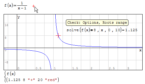

In fact it should not be necessary to define the search range of solutions. A search range is still defined in the general options, and sometimes you need to take a look before you run.
The discontinuity of the function at x = 1 creates some numerical problem.
As shown in the figure, trying different intervals are obtained unexpected values.
[albumimg]1436[/albumimg]

... always plot before solving, bracket the range wisely [1,2]
