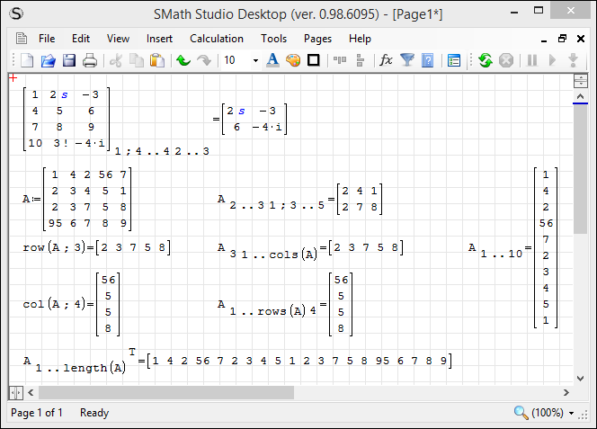

Release Candidate: SMath Studio 0.98.6096 available
Latest changes (against SMath Studio 0.98.6089)
  • Added ability to retrieve submatrix of specified rows and columns using ranges within el(..) function;
