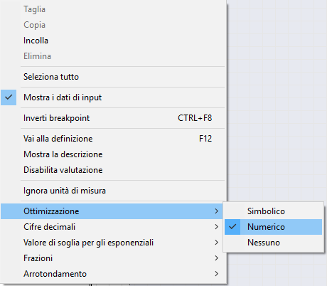

WroteOn the other hand, the while loop must be "Numeric" NOT Optimiz
Also, part of the while loop does not like Units.
Would be wise to work unitless.
Is there a way to understand during debugging if and why the units are creating the problem?

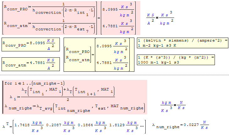

I know Jean has an aversion to using the built-in unit system within SMath, but I use it frequently without issue. I've not noticed a decrease in performance when using units vs. defining programs to be unitless. I personally think the use of units in calculation is extremely useful in quickly validating general arithmetic and results. Working with units can sometimes be a pain in the sense that when generating equations/programs you may often run into issues where units don't match (and calculations cannot complete) or end results don't make sense. Again, I find this useful in understanding all the different components of the equations/programs I generate.

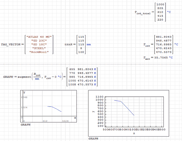

WroteA small modification
Thanks Carlos for doctoring this project.
1. Refreshed a bit
2. Few more things at the end.
3. "L" is confusing as not explained ... considered "unary"
4. Two pests [in green] wrt to units.
5. The last 4 "clear" removed from program [avoid red]
Wait and see for Originator to comment/complement
PROVA CONDUZIONE TERMICA_bkp_CBG [Jean].sm (344.38 KiB) downloaded 1100 time(s).

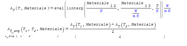

I will review all the contributions one by one, I just had the chance right now to go through the posts now quickly..
The use of eval() is somehow new to me, I will look at it's implications, since I understand that it has improved a lot the execution time.
Yesterday morning I spent some minutes again testing my file and became suspicious at how I implemented lambda.
It looks like I was accessing to that database matrix a lot of time.
Now I see that a great improvement has come from this eval() function...

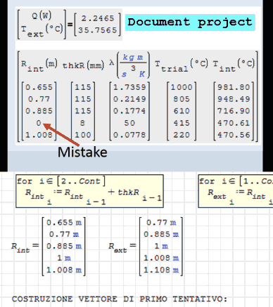

WroteHello Jean
I think there is an error in the internal radios.
Thanks Carlos: my mistake from copy/paste, delete 'm'
Forgot the unit system bug that does not output 0m, 1m.
That bug was reported long time ago, may have corrected in 6671.
Added: Hermite sub-space fillet.
Project PROVA CONDUZIONE TERMICA_bkp_CBG [Jean].sm (390.83 KiB) downloaded 1087 time(s).
I'm happy to see that the "while" was messy, not commented properly, etc etc... but it could work (with some help)!
And also the lambda function and the way I defined the database...
First of all, going to your contributions, now I see what Jean meant with one of the first replies:
I needed to right click and set the while to Numerical optimization?
Setting my original file this way, makes the loop work quickly (shame on me, I wasn't even aware of such setting...)
Also Alyses hint has helped me to understand that the symbolic evaluation was the problem, and that some different setting should be implemented.
Wrote... I did optimize run time of the current implementation. I used the eval() function in the lamda_t function definition...
Iinfact, the following files by other users did not use the eval() function, so I was kind of lost, until I found that right click setting...
So, in the end, if my understanding is correct, eval() and right-click numeric optimization setting are equivalent, isn't it?

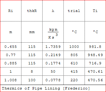

Jean, what command are you using to generate this kind of matrix? What is the sintax, I mean,to define Q(w) or T.ext (°c) and obtain results without Units? Looks like it is a Custom Function again.
WroteWroteFew more things at the end.
Thanks guys, I definitely learnt something (to say the least) from this thread.
Federico
Ps: by the way, totally on the same page here, but I see Jean's point in running unitless with his example he provided too...
WroteI personally think the use of units in calculation is extremely useful in quickly validating general arithmetic and results. Working with units can sometimes be a pain in the sense that when generating equations/programs you may often run into issues where units don't match (and calculations cannot complete) or end results don't make sense
Wroteean, what command are you using to generate this kind of matrix? What is the sintax, I mean,to define Q(w) or T.ext (°c) and obtain results without Units? Looks like it is a Custom Function again.

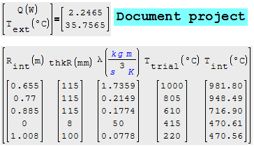

That, mon ami, is too simple doing ... like this:
1. from the matrix palette, insert a 2 rows by 5 cols
2. in 2nd row, paste results from above results,
backspace on units Rint ... bacspace on all 'm'
3. in 1rst row, type trial(Alt+248C) => trial(°C)
4. λ(,) ... kg*m/s^3*K from result above
This type of matrix project collection is natural, fast
and fully accessible by more maths from other demands.

About your other question: optimiz mode, eval there is no clear 1/1 answer.
In some advanced maths, the RHS , i.e: the function must be set in eval(,) mode.
Observe: Genfit Rational Type J_6
1. Minimize(XY,f,φ,β) .... some eval(,) within overall numeric
2. φ(x,β,f,n) ... strictly symbolic
3. eval(Φ^-1)*d ... eval(,) within numeric

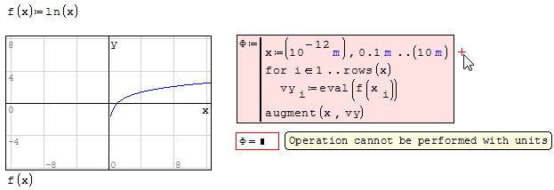

WroteSo, in the end, if my understanding is correct, eval() and right-click numeric optimization setting are equivalent, isn't it?
Not so simple !
In the just attached Hermite Polyline, open the first collapsed area.
Observe eval(,) in the subspace module, this is a case of local definition.
Couldn't reduce the height of the two first rows ... Ah !
