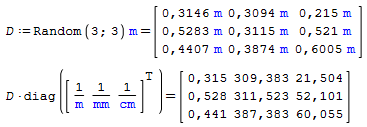

Assuming you have a table with columnwise uniform units, then the following approach provides full control:
exportdata.sm (4.81 KiB) downloaded 1210 time(s).
Alvaro 2/1/2020 4:59:00 PM
