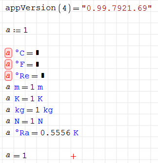

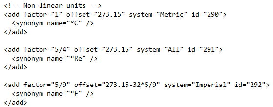

Very strange, seems to be °C, °F, and °Re.
Interestedly enough, these are the units labeled in the units.xml file as nonlinear. I don't know what any of this means, but I'm sure it has something to do with the built in functions that get us these three units.

Keep in mind that if you define a new dummy unit for °C by adding a "'" to the front, you don't solve your problem.
The conversion for these 3 units is not linear, meaning you can't just multiply by a factor to get the conversion.
If you are only planning on working with your own isolated units without taking advantage of the built in units, then go right ahead and define a custom version of the unit.
This issue needs to be solved in the programing or with a custom function that does the conversion for you the right way and can handle the nonlinear units.

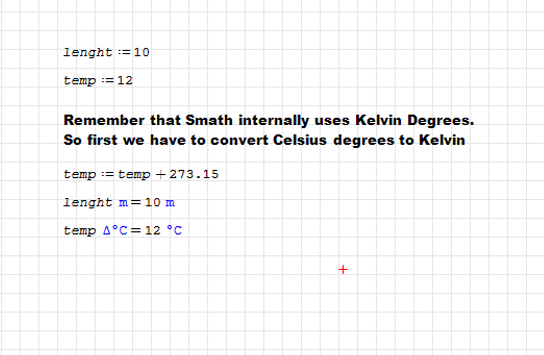

Hello
I think the following can be done
Carlos

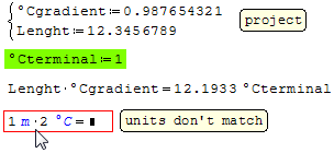

The issue originally mentioned by Porschaka looks like a bug,
OK Oscar, explain to yourself what the unit should be:
10m*1°C ... Ask SI Community.
Eager to discover ... Jean.
You assign unit to undefined,
do it otherwise: put °C in result.
