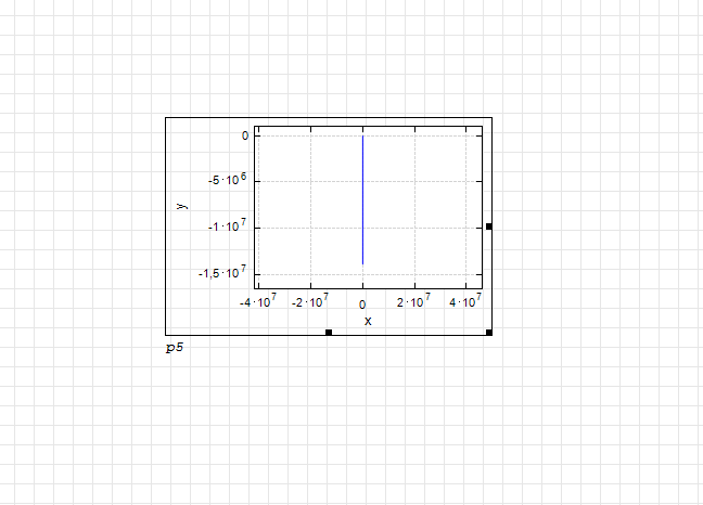

Hello Viacheslav,
I attach here the two different file, lsodaMAP3 have the problem solved, lsodaMAP2 show the error.
SMath version 0.99.7610.506
lsoda version 0.1.7175.9902
File not found. File not found. File not found.
Playing a little bit in the lsodaMAP2 I was able to make it show the chart with the "problem".
Let me know if you need anything else!
All the best
Francesco

#3 Posted: 12/2/2020 5:49:33 PM
The problem is in the X-Y Plot plugin. It cannot display the input data because it is outside the normal bounds. Also in the document somehow the min and max values of the axis are the same, which also results in an error. It will take a time to fix this. I haven't tested the plugin on bad data much.
