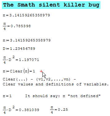

#4 Posted: 3/31/2016 10:22:27 PM
Please don't reply: do this, do that
Smath does NOT do first, I don't have to do what it should do.

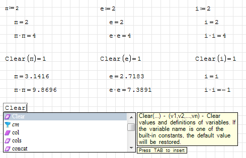

#6 Posted: 4/1/2016 6:56:42 PM
1,443 likes in 2,936 posts.
Jean, thank you for pointing out the different behavior of Clear about built-in constants. My fault, was in my knowledge and I've forget to document it.
I've updated the plugin (SS 0.97.5346 and later), now the description of Clear(...) reflects also this behavior.
