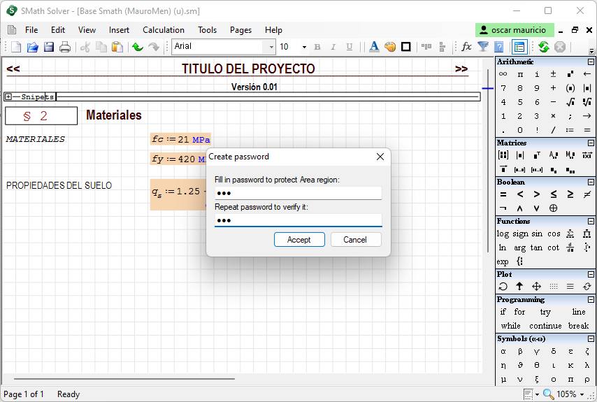

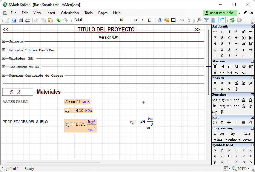

Hi, I find a similar error when I use region protection and secondary areas are contained in the area.

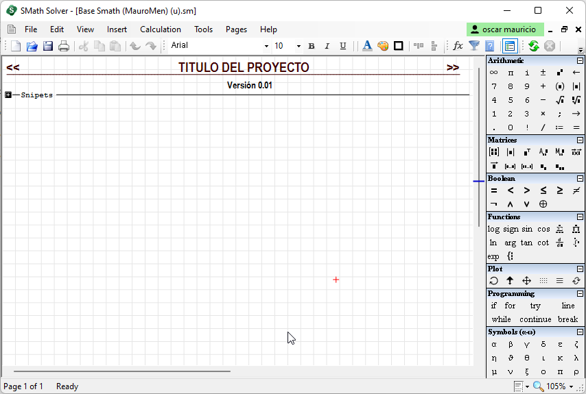

When opening the sheet all content is protected
