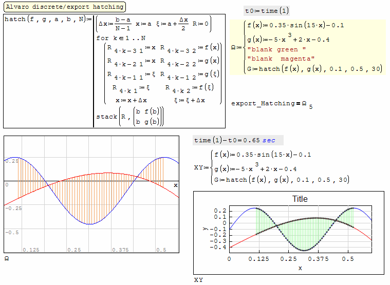

#3 Posted: 10/11/2013 5:58:10 PM
Fridel Selitsky
Fridel Selitsky
520 likes in 451 posts.
Graf1.smz (2.99 KiB) downloaded 1823 time(s).
Вячеслав Мезенцев 10/14/2013 4:30:00 PM, Martin Kraska 10/12/2013 4:21:00 AM
#4 Posted: 10/12/2013 4:24:04 AM
1,361 likes in 2,275 posts.
It's amazing how compact the code is!
#5 Posted: 10/18/2013 5:25:49 PM
Fridel Selitsky

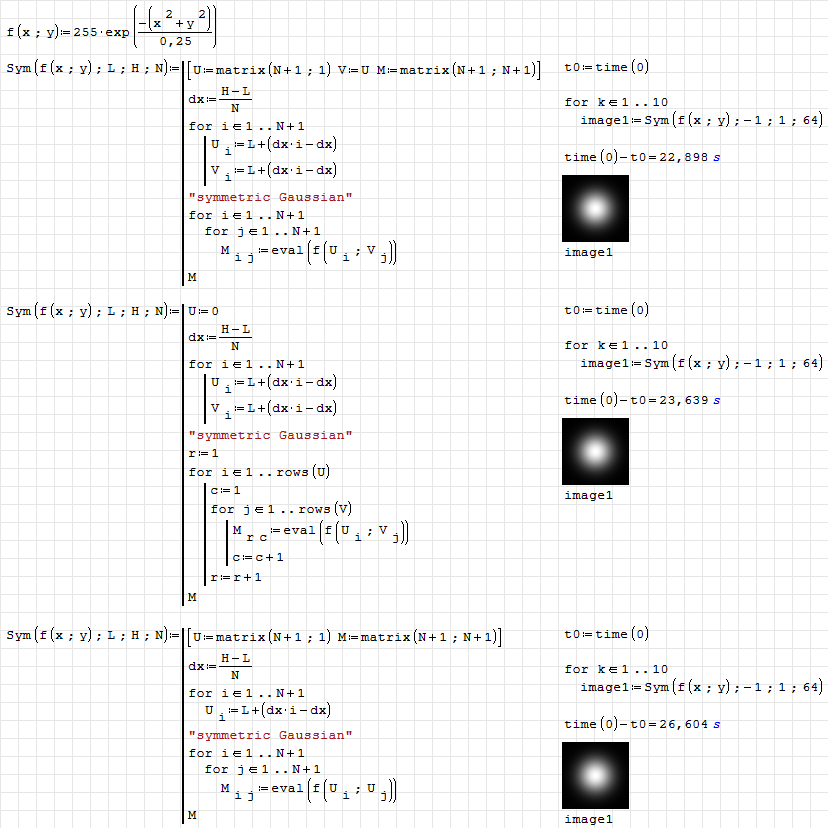

Fridel, thanks for revisiting the snippet and the performance issue. Quite odd for me: The fastest way seems to be direct element adressing without pre-allocation and avoiding stack(). See attachment. The speed-up is significant.
Please post any response to the new dedicated topic
I understand that stack or augment are bad strategies, but without pre-allocation is better than with pre-allocation? If it is, why is without pre that good. Seems to be to much faster than I can explain or understand.

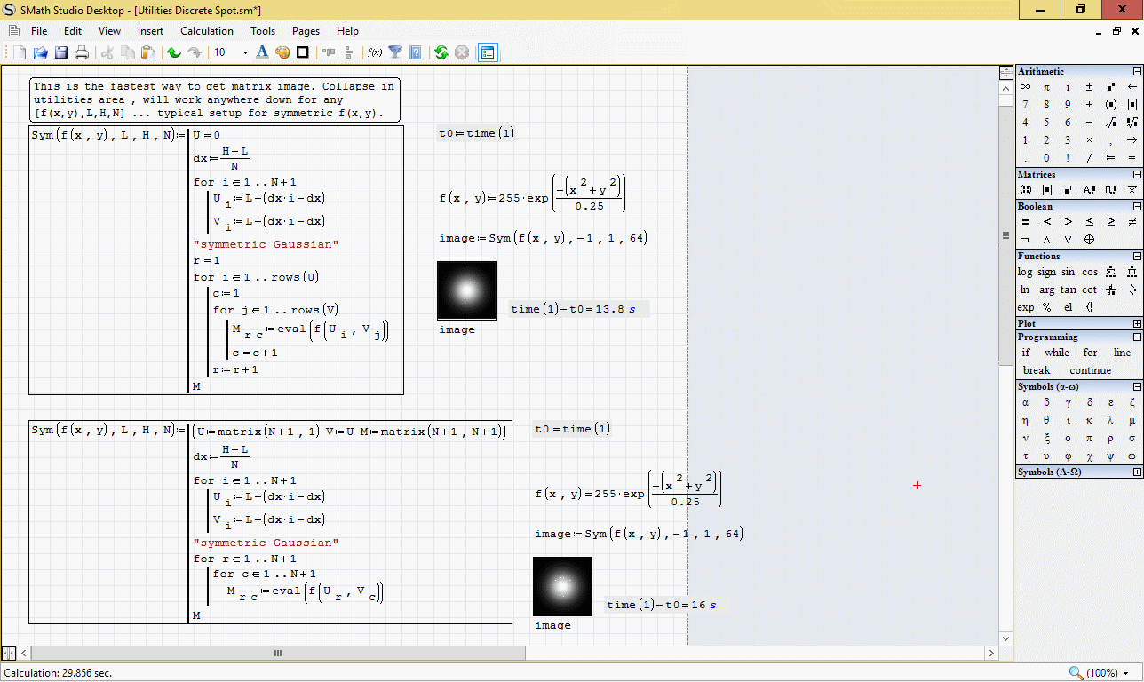

#7 Posted: 6/5/2016 2:11:03 AM
"memory allocation" vs "memory NOT allocation" is confusing to me.
Memory allocales itself from the construction. Visit the "Spot"
"stack" is very fast as being a vector operation. "augment" is slow
as not being a direct vector operation, but very fast within a program.
"hatch" creates a virtual matrix, a scalar matrix, i.e: a matrix at the
plot canvas. Same principle than plotting f(x) on the QuickPlot canvas.
Great construction, though I never used it. Watch it does not face infinity
governed by the N ... at infinity: it crashes Smath !
Forum Test Derivative.sm (11.13 KiB) downloaded 1657 time(s).
Utilities Discrete Spot.sm (12.07 KiB) downloaded 1676 time(s).
#8 Posted: 6/5/2016 2:25:31 AM
1,139 likes in 1,805 posts.
Using stack, if you have a vector, lets says, [x,y,z], then stack(t,[x,y,z]) must to force to push z from 3th plate to 4th, y from 2nd to 3th, ... for finally, put t at first place. And that's can take a very long time.
Preallocating is when you say "let's V:=matrix(20,1)", and then just work defining V[1, V[2 ... etc. If you found that don't need all 20 numbers, just can use submatrix. But if you don't preallocate V, but use V[1 ... V[20, and program work fast, who is preallocating must to be SMath, and that's isn't very efficient for the general cases. Or have some pointer very good for handle that matrices, and I don't know C at that level.
In your example, "Utilities discretes", it is suposed that defining U:=matrix(N,1), and same for V, must to be faster than having U:=0 and then use U[i
#9 Posted: 6/5/2016 2:41:38 AM
It is supossed that second algorithm must to be faster than your's, but it isn't.

#18 Posted: 6/6/2016 4:34:38 AM
My versions for fill and hatch.
Have a nice day.
FillRnd.sm (44.23 KiB) downloaded 1699 time(s).
#19 Posted: 6/6/2016 9:39:37 AM
Only the first module works. The ones "if/else" do not in Smath 5346
The first module is fully compatible with Maxima X_Y plot, i.e:
traces color, symbols, hatching color ... great for publishing.
Martin scalar hatching is slightly faster, not to account in project.
Your module [Alvaro] is great for extracting a particular bar but
couldn't add to the plot ???
Tanks, Jean
2DPlots Hatch Demo [Martin, Alvaro].sm (23.45 KiB) downloaded 1466 time(s).
