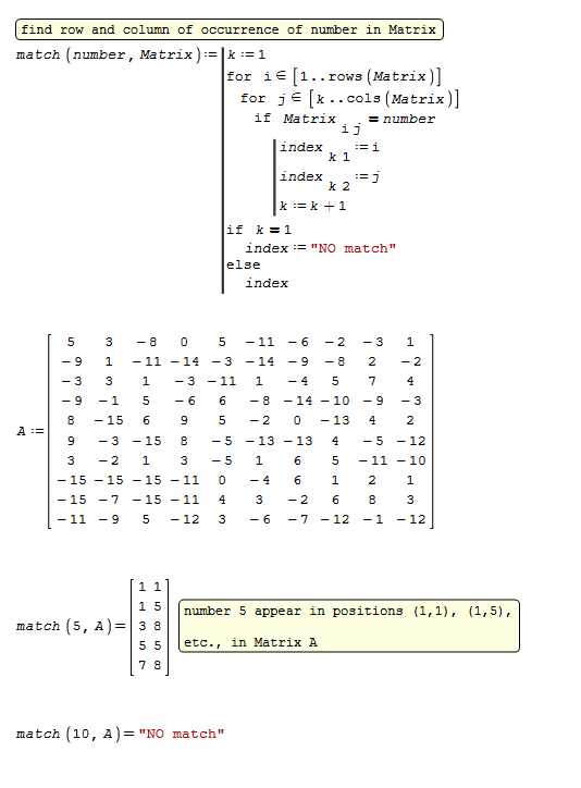

Hello, I'm searching for some function like match(z, A)(Looks in a vector or matrix, A, for a given value, z, and returns the index (indices) of its positions in A) in Mathcad.
I will appreciate any kind of help.

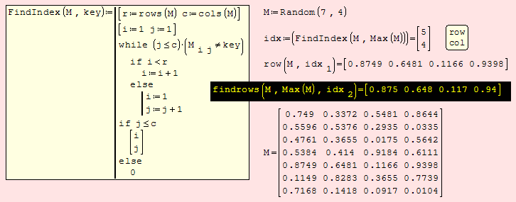

#5 Posted: 10/13/2022 10:04:54 PM
Can I access this function ?
findrows from Smath menu f(x) may just be what you need.
Truncate the matrix/vector to avoid residuals smaller than 10^-15
For more complicated investigation, visit Samples Find Index
posted few days ago ... lot more involved.
Cheers ... Jean.
#6 Posted: 10/14/2022 9:12:57 AM
findrows has limited use unless for specific end use wrt Bolean '0'
For long square/rectangular matrix, better use the assisted code.
match.sm (11.95 KiB) downloaded 1655 time(s).

#8 Posted: 10/26/2022 4:26:45 PM
Oscar Campo
Oscar Campo
135 likes in 309 posts.
Some good improvements suggested by Razonar: versions of match() function
