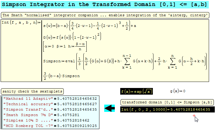

The test function looks naive, it is not so. Ordinary Simpson 7½ D.
Same test function in the transformed domain boosts accuracy to 14½ D.
That would greatly enhance Smath vs competition.
I spare many hours trying to code Romberg, what a f...n mess.
Rather deceiving, though sometimes as good as Adaptive
RemToDo if I can convince myself !

... don't miss the 2nd example ... most remarkable for SimpsonTransform
