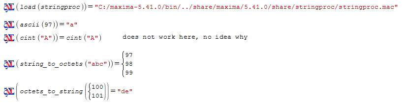

There are some conversion functions in Maxima.
ascii.sm (4.27 KiB) downloaded 1133 time(s).

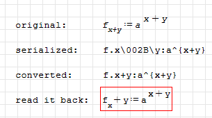

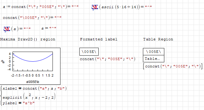

There seems to be something special with the characters generated this way. They will be backconverted to code sequence if used in Maxima region, label region or table region.
Zeichenketten.sm (57.75 KiB) downloaded 1060 time(s).

Now I know why cint("A" ) does not work. It is a translation problem from SMath to Maxima, see SS-3543.
#8 Posted: 6/18/2018 12:29:10 PM
1,443 likes in 2,935 posts.
They are special indeed, you can see it by exposing the plain text with copy/paste... The syntax is handled at code level by the math region (like a bbcode or a markdown text)
