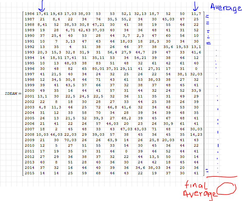

hi...I need find the average of each row (without include the first number) and at the end find the average of all averages....thanks for the help

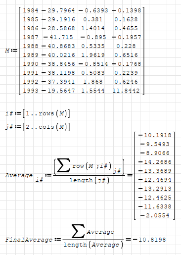

Had you attached the table ... job done.

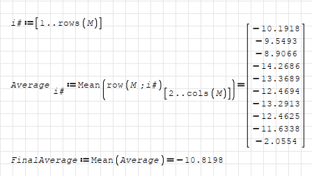

Average.sm (9.28 KiB) downloaded 1080 time(s).

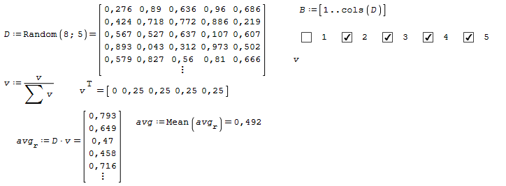

Another version with scalar product.
Easy to adjust to arbitrary subsets of columns.
avg.sm (6.53 KiB) downloaded 1116 time(s).
