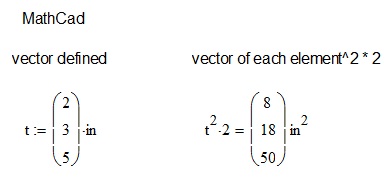

I would simply like to define a vector, then apply a operation to each element and have the results in a second vector. This seems to be simple in MathCad but I can't seem to get it in SMath Studio.
In MathCad

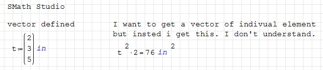

In SMath Studio I get this. I'm not shre just what this result is.
Any assistance would be appreciated.

The result is the sum of the squares of the elements, multiplied by two.
As far as I know SMath does not support vectorization (yet) so, in order to obtain what you need, you should use a for loop.

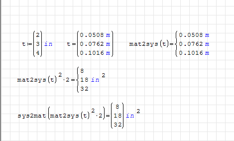

If you are using vectors, then you can try mat2sys() and sys2mat()

Thank you mb10, I got the For..Loop to work it out. I was wondering if the vector options were available or not.
To omorr, the mat2sys() and sys2ma() looks like a clean method to acheive these functionality but how do I add the mat2sys() and sys2mat() functions?

#5 Posted: 10/16/2013 4:46:28 PM
1,359 likes in 2,273 posts.
mat2sys and sys2mat are part of the CustomFunctions plugin by Davide Carpi. You can install it using the extension manager (Tools> Plugins) or use the unofficial distribution with pre-installed plugins (link in the signature).
