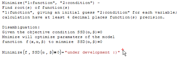

Ah, yes... Minimize/maximize are part of the NonlinearSolvers plugin. Before implement them or add new algorithms, I want to improve several things in the plugin.
As for now you can use the following:
GoldenSectionSearch.sm (21.17 KiB) downloaded 2048 time(s).
GradientDescent.sm (16.99 KiB) downloaded 2266 time(s).
NCGM.sm (19.68 KiB) downloaded 2285 time(s).
LevenbergMarquardt.sm (45.97 KiB) downloaded 2354 time(s).
NewtonMethod.sm (18.79 KiB) downloaded 2342 time(s).
NelderMead.sm (33.02 KiB) downloaded 2251 time(s).
GaussNewton.sm (20.15 KiB) downloaded 2360 time(s).
I see that Smath 0.97.5346 doesn't prompt the plugin requirement form --> before opening the worksheets, go in the Tools > Plugins... > Online Gallery and download the latest update (I've fixed a small issue).

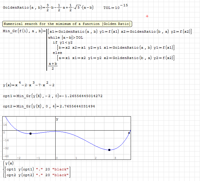

Thanks Davide,
"GoldenSectionSearch" works fine. I have added the Mathcad 11 equivalent,
just a bit more compacted. The Mathcad "While" loop is self indexing but
NOT attempted to code, because your coding is more complete "target" min/max.
In the attached work sheet, I give the solve block [much faster].
Nice to know how "GoldenSectionSearch" works under the hood.
I will visit more from your work sheets.
Interesting the implicit coding:
Cheers, Jean

Very nice Jean
As for the truth it is possible to code Min_Gr like in mathcad; you need SMath 0.98, since previously the parsing order of assignments inside matrices was made in reverse order (that makes it possible to code it even in SMath 0.97.*, but in a cucumbersome way)

WroteVery nice Jean
Yes Davide !
Can't be more right. Smath official 5346 does not digets the Mathcad code as you have
implemented. It made me shovel the clouds for a while ! While loop !
Just between you and me, Andrey has received my special "birthday card"
