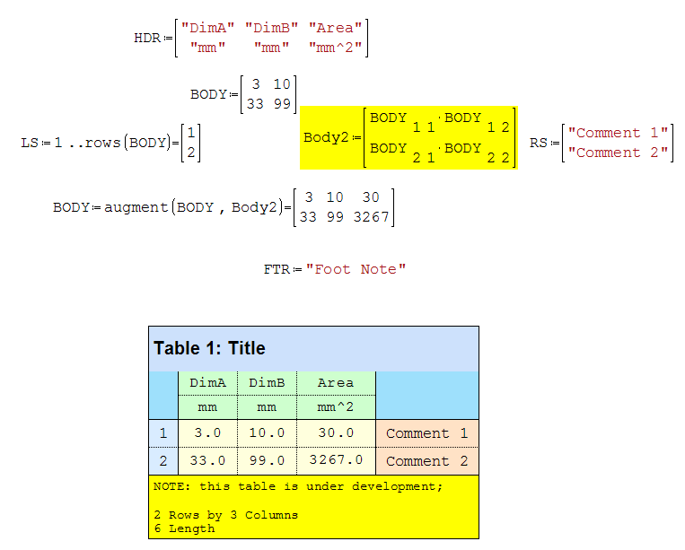

I'm trying to create an input table for a worksheet I'm working on.
It's probably a bit of a newbie question but I'm new to SMath (and matrices !) so any help would be appreciated.
I want to perform calculations on the data in matrix BODY.
I've done this in BODY2 as a workaround but I'd like to find a way of doing it so I don't have to edit BODY2 everytime I add or delete a row.
Any help / guidance would be appreciated
Peter

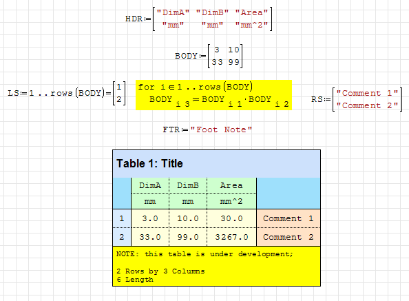

Hello Peter,
You can use a simple loop, like this:

Thank you Davide
As I thought the answer was simple but I just couldn't see it.
I've been using Mathcad for a few years but have recently discovered SMath and am blown away by it.
