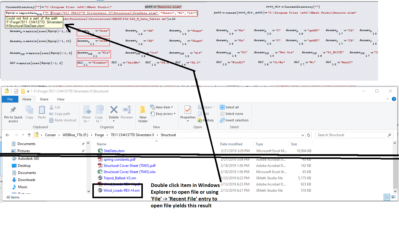

I get this odd behavior opening files from either the recent file menu or by double clicking the SMath file in Explorer.
SMATH thinks the current directory is C:\Windows\.... and therefore it can not find the files I am trying to read in.

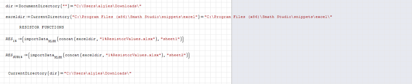

I found in a snippet of mine where I import an excel file, I did something like below.
1. Save document directory location.
2. Change directory location to file I want to import.
3. Import sheets
4. return current directory to document directory.
I don't know why I did it like this as I made it years ago, but maybe I ran into a similar issue.
Show Spoiler

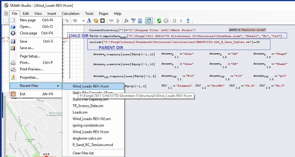

If I do not explicitly define the filenames, then when I copy the files as templates, SMATH seems to remember the origins and relative paths from the origin. So the 'child' SMath sheet finds the 'parent' SiteData spreadsheet.
The referenced include statement, which is obscured in my original post, is pointing back to the 'parent' location of the templates too. Perhaps that is part of the issue?

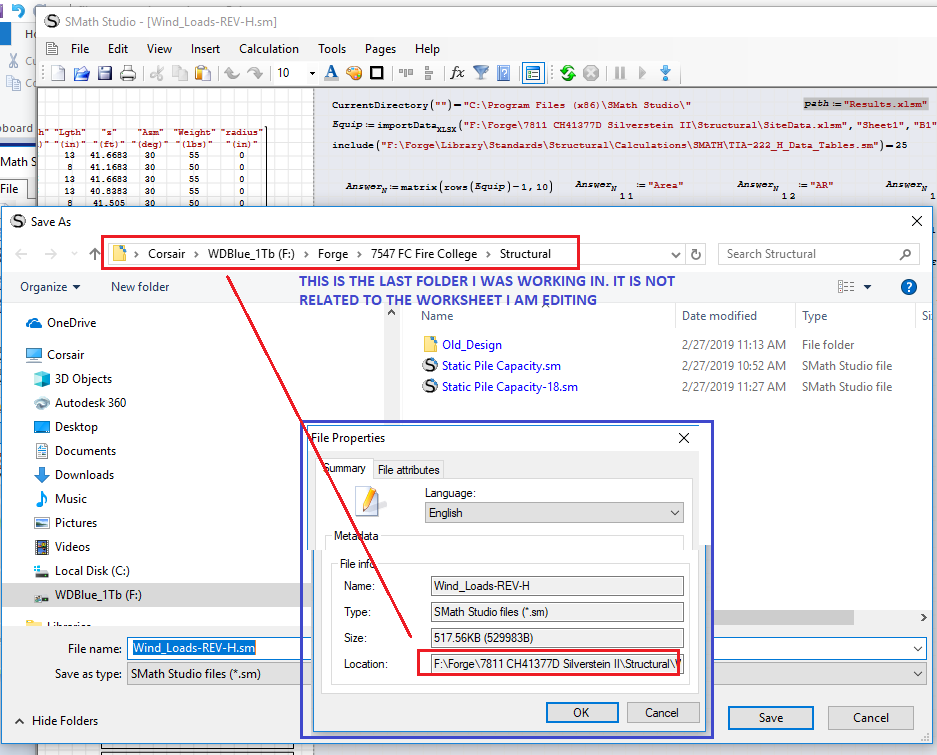

Even if I open it from the File Menu -> Recent Files -> entry, it opens with the wrong CurrentDirectory().
Then when I go to save it, SMath seems to remember the last directory that I was working in.
Are these both symptoms of the issues you referenced? Is it the same error reported in the newer thread?
See screens below.
