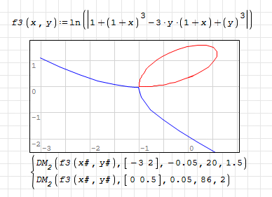

An easy setup for the uni's Draghilev method for plot implicit plane curves.
dm_revisited_correct.sm (34.71 KiB) downloaded 1968 time(s).

Original Uni's Dragilev works fine 6179, not your latest SS 6179.
Keep up Alvaro !

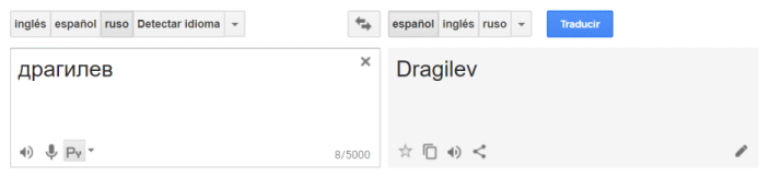

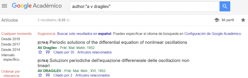

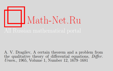

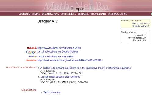

Thanks! It's very important use the correct reference. But actually I'm not sure about the correct name: Google traductor isn't an authority for me, and I prefer to trust in your knowledge, but:
Translating to spanish it is: https://translate.google.com.mx/#ru/es/%D0%B4%D1%80%D0%B0%D0%B3%D0%B8%D0%BB%D0%B5%D0%B2
To english, from http://forum.exponenta.ru/f-x-0-t3892.html
From google academic: https://scholar.google.com/scholar?hl=es&as_sdt=0%2C5&q=author%3A%22a+v+dragilev%22&btnG=
Form http://www.mathnet.ru/php/person.phtml?&personid=32359&option_lang=eng
and ( http://www.mathnet.ru/links/3c8499a4720a6eb7bcfc74a0694d5b23/de9397.pdf )
and some others.
Maybe someone can contact the author or some friend of him.

Please do not give dubious arguments. It was the request of Anatoly Vladimirovich Draghilev himself. Writing in a different version occurred besides his desire.
Драгилев Анатолий Владимирович (1923-1997).
If this means nothing to you, then, of course, you are entitled to do what you want.

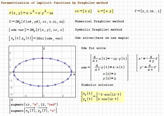

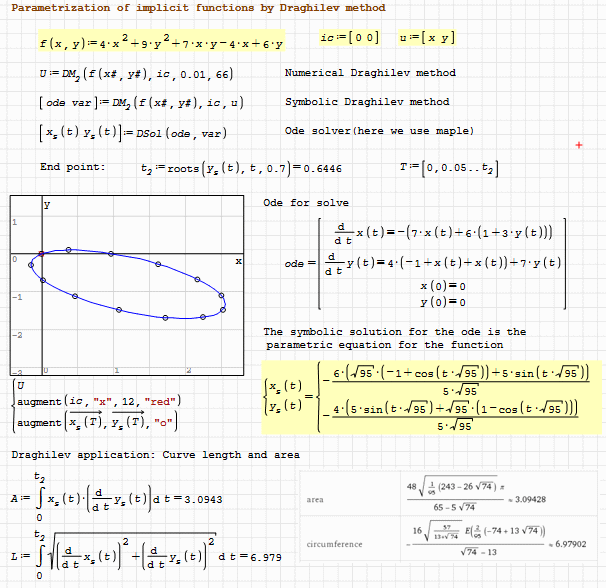

Hi. I post this example of the uni's procedure implementation because not just it's more easy for some curves, but it show that we don't need to use the parameter, even the original procedure talks about the parametrization of the curve (one of them, the other, as uni explain in other forums, and apply he and others here, is for search intersection of curves).
Both Runge Kutta algorithms RK2 and RK5 in the numerical procedure don't achieve the "time", this is, the parameter, and the function D(t,x) usual in the rk solvers is just D(x) formed only by elements of the jacobian. This situation seems to me that even the algorithms came from derivatives, looks more like a global property of the function more than a local one, like the case of the derivative (local) and it inverse, integration (global).

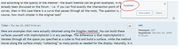

By the way, I have seen Uni in the PTC forum, specifically about Draghilev
Contour_9 Draghilev [Human eye].sm (31.54 KiB) downloaded 1716 time(s).

Hi.
I don't see there a full explanation about the Draghilev method. I see only an application for the method, the seek for roots of a system of equations. That could give a poor idea about the meaning, importance and interpretation of the method.
The method it's about the parametrization of a function f:R^n -> R.
For instance think at anything more easy to do with the parametric equations rather than cartesians, and you get a new application for the Draghilev method.
In this file, maple is used only as symbolic solver for the ode's.
dm.sm (84.52 KiB) downloaded 1882 time(s).
