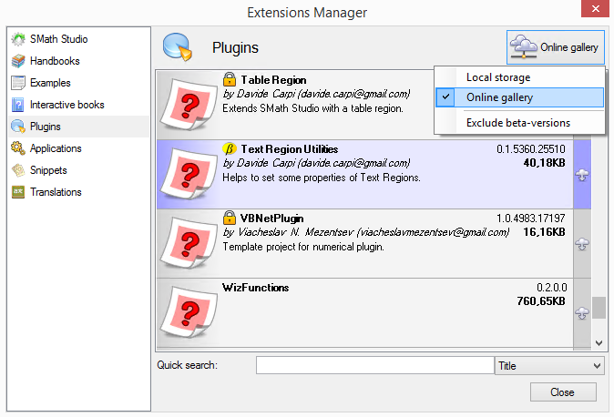

#4 Posted: 9/6/2014 1:33:42 PM
2,343 likes in 4,044 posts.
Ernesto, Extensions Manager allows to update plug-ins.
Please see attached image. Select Online gallery and see the list - available updates shown in violet.
