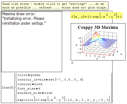

My comment is in thre parts:
1. My SS will be 5346 for ever on XP. If my actual XP burns
I have alternatives: another XP Home, another XP Pro. and one Millenium.
An acceptable alternative could be some updated Plugin installable on 5346.
2. The "dead stone Maxima" is not worth a comment. If it's not possible to
copy paste the Handbook demo and adapt to other stuff: Draw3D => recycle bin.
3. "Crappy 3D Maxima" speaks by itself:
No user mesh density in both X/Y directions.
No user mesh color. The actual default gradient color is non-sense.
The "non-sense gradient color" is blind to color blind person(s) and
"3D flat person(s)".
In short: 3D Maxima is not even pregnant of the 3D first essentials.
#2 Posted: 10/17/2016 6:47:36 AM
1,362 likes in 2,276 posts.
Works for me even with the most recent SMath version.
"do as much as possible" is a very individual thing. Does it include using a clean SMath with Maxima portable installation?
Please note:
The plot shown by Jean is a 3D Plot Region provided by the 3D plot plugin. It is NOT related to Maxima.
#3 Posted: 10/17/2016 7:36:41 PM
That's right: NOT a Maxima, just a plot region like X_Y
In fact, it is NOT a 3D, simply a 2D parametric.
The function in "Draw3D" is misleading: it is a symmetric
Gaussian. Levels are pure circles.
The attached demonstrates some useful "contour" tips.
