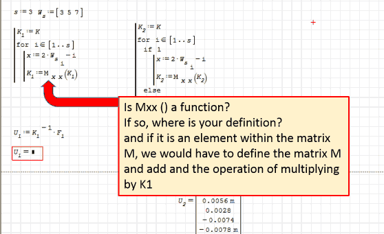

I wonder why left matrix give error and right is ok?

I think some definitions are missing

No, it's the operator formatting of the built-in minor() function. Can be found on the Matrix palette.

Ufss!!! Sorry !!!
You are right.
How I did not see it defined in the floating panel?
Thank you
Carlos

Seems some issue in the symbolic engine about the inversion of minor() when there are units
Because the right one comes from an if/else, that force a numerical optimization context while in the left case it's in a symbolic context.
To figure out the difference between K.1 and K.2, look at their content
  • add a breakpoint on Mxx and look what it happens inside the loop in the 2 cases
  • alternatively write on the canvas K.1= and K.2= with "none" optimization
