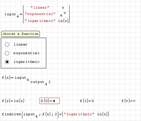

I noticed that when a matrix is taken as input source, the output is no more the selected line number,
but it corresponds to the value for the selected line in the second column of this matrix.
From my viewpoint, it would be preferable to have as output always the selected line number, in order to be able to recover the whole line of the matrix, especially when the matrix has more then 2 columns (!?).
Ok, I can easily suppress this feature, I've just reproduced the combobox behavior

I've updated the plugin, now the output is always the item number; thinking a little while about it, my opinion is that the default output should be this... I'll think if and how to introduce a choice to the output (the ordinal number rather than the whole row or an element in a column...)

I do not really understand the problem with the return values taken from the second column of a matrix. If the line number is the desired output, just fill the second column with appropriate numbers or access the complete line via findrows().
Davide Carpi 3/14/2014 7:10:00 PM
#9 Posted: 3/14/2014 8:15:17 PM
1,443 likes in 2,936 posts.
Thank you Martin, this is true
From my point of view there are enough tools to make any solution usable, but there are "better" and "less better" ways.
Talking about general cases, with the first approach (emulation of combobox behavior) if you want the index from a matrix for post-processing purposes (get the whole row, get the n-th element of that row, or get something else not directly related), you need a pre-processing by assigning the first column to a new variable or some post-processing operation (like that made by you with findrows; here you assume that the second column contains only different values, but you may encounter some problems when the second column contains several equal values).
In the other hand making the option index as output always available there's no needs to make pre-processing operations and any post-processing operation could start from an unique identifier without issues; moreover, as I've written in my previous post, I think that it's possible to move the most common desired outputs directly inside the region dialog (if my explaination was not too much confused, it should emerge that these options are for a very specific context, namely that in which the region drives only the parameters of the input matrix; if the region drives also other things, like corresponding parameters in other matrices/tables, the index is again the most important thing). As "secondary" matter, this is a more linear approach: any allowed input returns as default output the row index of the selected item).

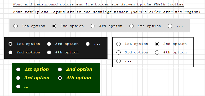

Do you imagine a font control for the list. As it is, it seems using an embedded unique font, without any possibility of changing ?
Actually there are some small issues in Math regions when you change the fonts (you can see something exporting the example worksheet in SMath Viewer), but is it in my plans...

UPDATED
(SMath Studio 0.97.5189)
  • BTS SS-103 features (extended)
    - select input column
    - select output type (index, element from a column, whole row)
    - select text Font
    - select text Color (from SMath toolbar)
  • RBs now uses MathRegions for any element shown (except strings at the first nesting level)
  • Added number's formatting (at the first nesting level)
NOTE: The plugin should be back-compatible with the previous version; this compatibility will be extended as long as possible but I suggest to update any document containing this plugin to avoid problems in the future.
