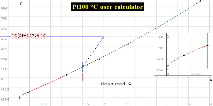

#1 Posted: 1/14/2019 6:16:34 PM
If you can find a PT100 measuring bridge of lab quality,
This Smath document will return °C from measured Ω.
On the other hand, if you have a decent scientific calculator,
plug/code the three functions. If your Pt100 lab bridge is
transportable in the jungle ... you will have plenty °C in hand.
Web search is pure waste of time. The only valid item is the
eit90 from the BIPM [Bureau International des Poids et Mesures].
A long lecture necessary to understand that final calculator.
Enjoy/comment ... need more, please feel free.

#2 Posted: 1/15/2019 8:36:15 PM
WroteA long lecture necessary to understand that final calculator.
1. Segments have been improved
2. Calculator refactored more intuitive.
Inst_Type Pt100 Calculator Copy.sm (286.12 KiB) downloaded 1264 time(s).
Genfit Techniques_16 [Pt100] Copy.sm (283.93 KiB) downloaded 1078 time(s).
#3 Posted: 1/16/2019 3:26:05 PM
Wrote1. Segments have been improved
1. typo corrected in 'β' ... f(x,β)
2. added CY7 cryogenic
Inst_Type Pt100 Calculator Copy.sm (304.16 KiB) downloaded 1237 time(s).
