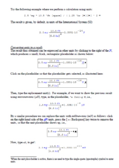

Nmm²:=1 ....... a:= 2, b:=2 .... a+b=4Nmm²

#5 Posted: 10/29/2017 8:44:45 AM
Attached are two typical Engineering projects that don't use unit system.
Standards are given in the appropriate unit system. So, you just need to
append the "UnitResult" accordingly to the formulation.
"Uconeer" is a freeware unit conversion software from "Katmar".
From "Katmar" you can get WASP [Water and Steam Properties]
Free use for 2 min session.
