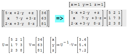

Hi, I am new to SMath and doing some exercises
How, to write the coefficients of LGS in a matrix?
What I have:
Any way to extend to a flexible amount of equations?

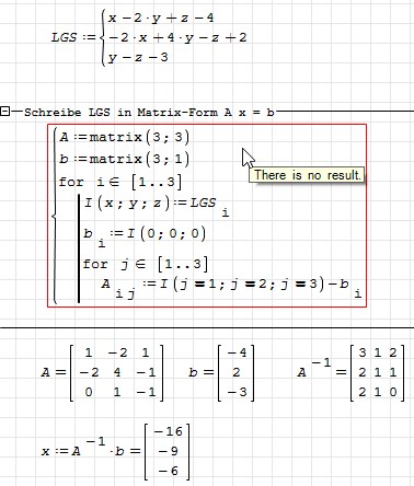

How to avoid No Result or is it OK to have no result?
I have some augment statements do not react to "Display Input Data" switch off...
LineZC:augment(mat(el(Z,1),el(el(L',3),1),2,1),mat(el(Z,2),el(el(L',3),2),2,1))

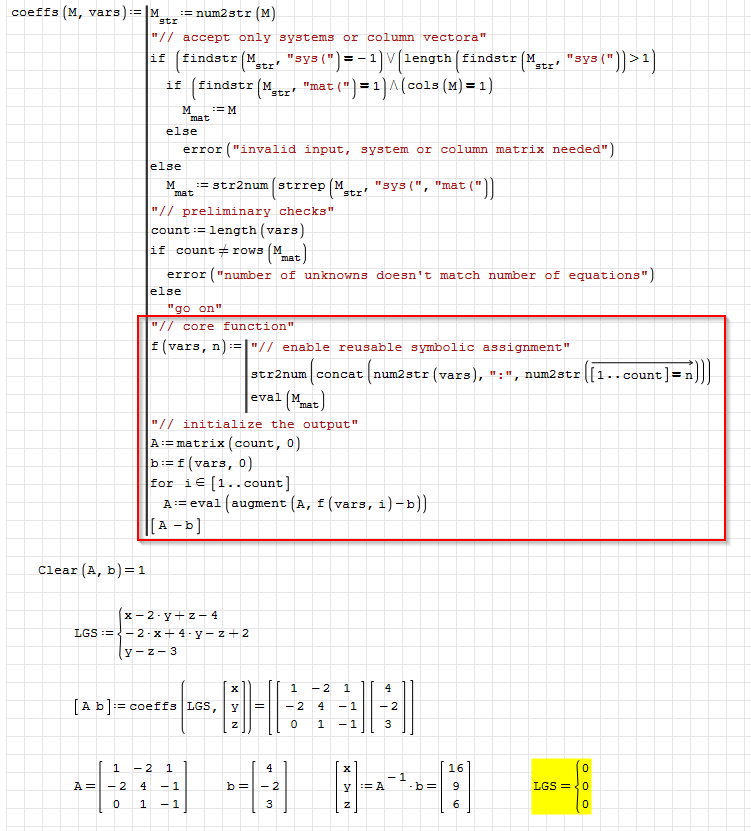

#4 Posted: 4/11/2020 11:18:21 AM
1,443 likes in 2,935 posts.
Here you have a generic function; the second one uses Unknowns from Custom Functions plugin, while the first requires you input the unknowns as second argument. Anything above the "core function" comment is just input checking, not strictly needed.
coeffs.sm (30.12 KiB) downloaded 1023 time(s).
As for the error message, don't put that line procedure in the system or change it to return a result (the result is taken from the last argument/placeholder in the line function, in your case there is a loop in that placeholder, that is why the program doesn't understand what should be the value to assign in the system).
Happy Easter and stay safe everyone.

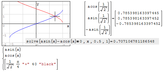

BTW.
Symbolic eval acos(1/sqrt(2)) = pi/4 but -asin(1/sqrt(2))=asin(1/sqrt(2))
ist this a bug?

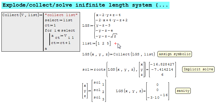

#7 Posted: 4/11/2020 4:18:39 PM
In my experience it is easier to write down the equations than to work with the matrix input - especially when revising, deleting or adding.
You have first shown solving, thus helped accordingly.
You can add/delete/collect shuffle unlimited from "list"
and not solve as you demand ... try it list:=[5,2,3,4,1]
No simpler method may exist than this algo style ... 1/1 Mathcad.
