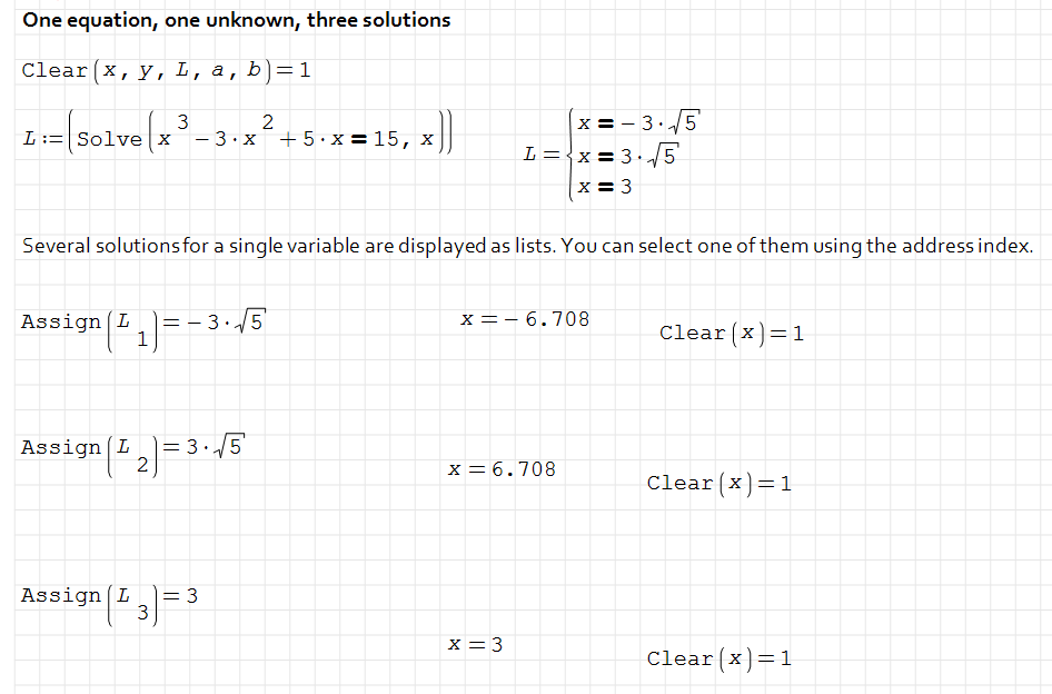

now I am studying SMath with SMath Studio Handbook by Dr. Martin Kraska.
this is SMath Studio Handbook page 110.

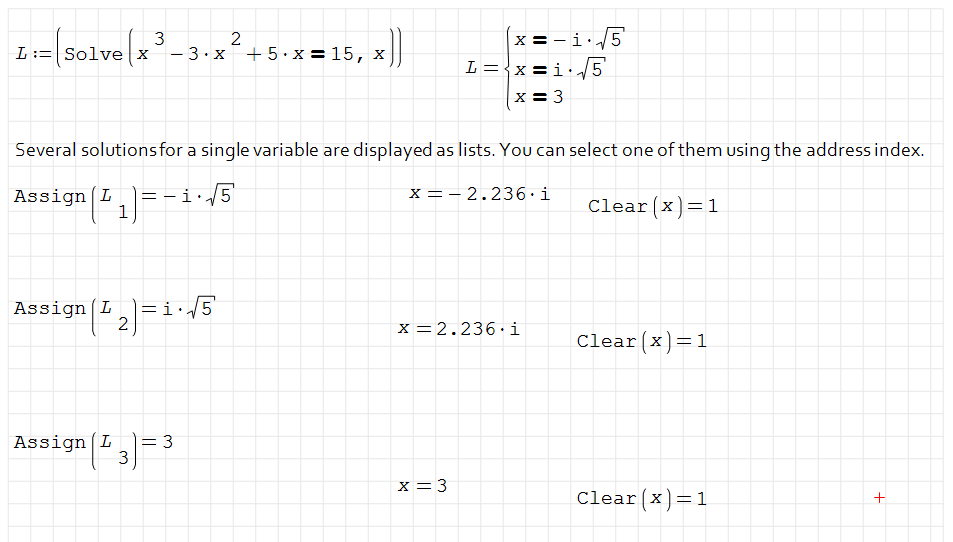

result is wrong.
I copied and pasted it into another file and the result is exactly the same as Math Studio Handbook.
i don't know what is problem.

In the main document you somewhere re-defined i. If you include i in the list of variables to clear, everything is fine.
