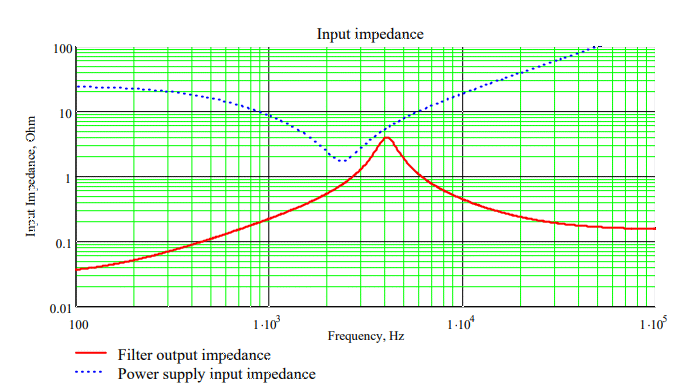

I am currently attempting to copy this app note here:
APP NOTE
In an attempt practice my smath.
My file may be found here V2_Input_Filter_Test.sm (81.88 KiB) downloaded 1347 time(s).
I am currently stuck on attempting to replicate page 14-15 of the TI APP note.

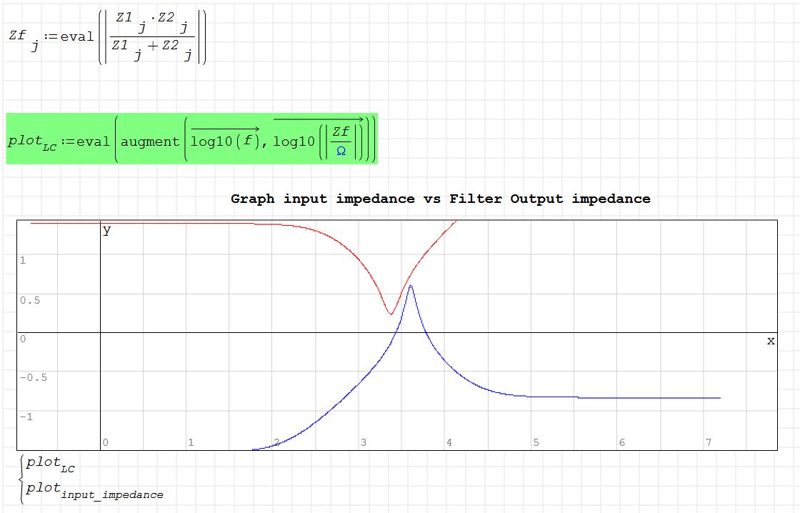

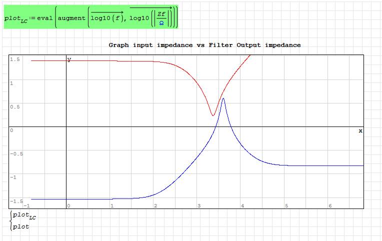

However, whenever I leave the values as i had them without vectoring them get the expected graph, which matches the TI app note. (see picture)

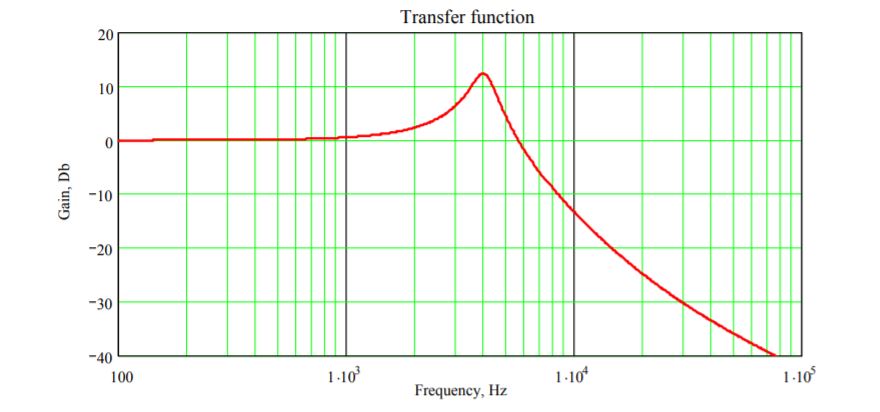

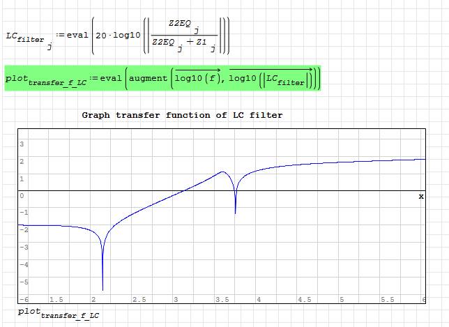

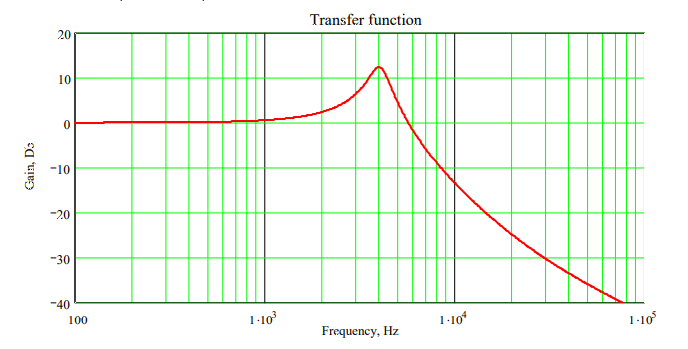

Now what really confuses me the Transfer function plot looks so different. I input it as the App note stated however the graph seems "negated" as opposed to what I would expect.

#6 Posted: 1/21/2020 10:35:03 AM
WroteAny Ideas Ya'll?
Same as the other one ... see reply.
Can't get that picture ?
#7 Posted: 1/22/2020 3:07:02 PM
Hi Carlo. You take twice log10. Just augment log10(f) and LC.filter.

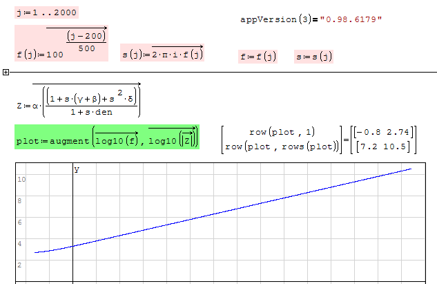

#8 Posted: 1/22/2020 6:32:49 PM
WroteI am still unsure as to how to what is the proper syntax on how to graph the transfer function
1. This is not XFR [Transfer Function], simply impedance.
2. Dimension the components wrt SI system [see TI values]
4. More help, re-post page 1 working from this document
5. Your version is older than SS 6179 ...
it does not have page # associated with the cursor.
HELPED_Input_Filter_Test_V1 ... first graph doctored NEW.sm (245.89 KiB) downloaded 1313 time(s).

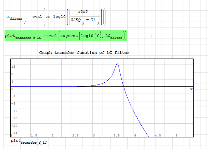

Hi. Not in that plot, in the previous:
Bad: Two logs:
Ok: One log:
This other have the same shape, and seems to have the same values than the mathcad plot in the TI app note. Notice that this plot is log only in the x-axis, and the y axis isn't in the log scale in the plot just because you're plotting in dB
The last plot is log in both x and y axis. See the difference in the green lines. So, you correctly take there here log for both axis
Bad: Two logs:
Ok: One log:

Thanks to Jean and Razonar I believe we can close this thread up! At least as it pertains to graphing indexed values.
The resulting file may be found here for reference:
HELPED_Input_Filter_Test_V1.sm (87.91 KiB) downloaded 1286 time(s).

This will be an attempt to get my graphs to look more like the following
But hopefully without that horrible green.
