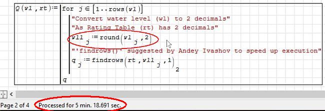

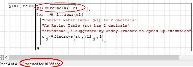

Examples compare speed of execution using Vectorize Operator vs Array Index in Large Matrix Analysis.
WL To Q_Array Index.sm (27.25 KiB) downloaded 1321 time(s).
WL To Q_Vectorize.sm (28.56 KiB) downloaded 1288 time(s).
1.July WL&RT.xlsx (29.52 KiB) downloaded 1084 time(s).

Hi. This is the help page for matlab about what their call (in matlab slang) the "vectorization process", instead of the use of "scalar approach" which include for and while loops: https://la.mathworks.com/help/matlab/matlab_prog/vectorization.html
So, scalar = for, while, slow, and vectorial = vectorize in smath, and fast.
Here attached a good demo.
VectorizTest.sm (22.24 KiB) downloaded 1363 time(s).
