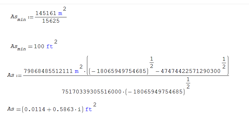

Checking your sm file, by debugging, I found the term As.min is a complex number:
Would you mind checking your numbers?

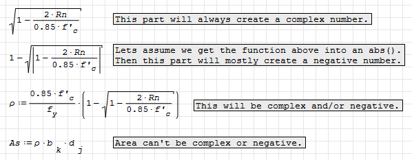

#3 Posted: 7/10/2021 12:44:11 AM
600 likes in 1,381 posts.
oscampo is right about your functions.
There are mistakes at this algorithm.

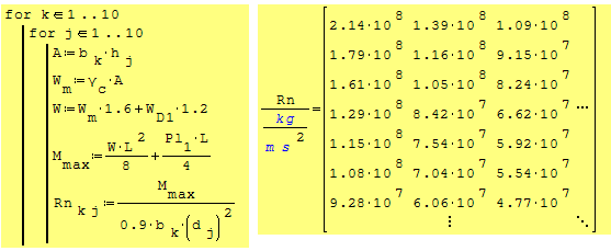

#5 Posted: 7/11/2021 2:46:37 PM
Isn't the double loop should first produce Rn 10 x 10 matrix ?
... then some suite wrt the project.
