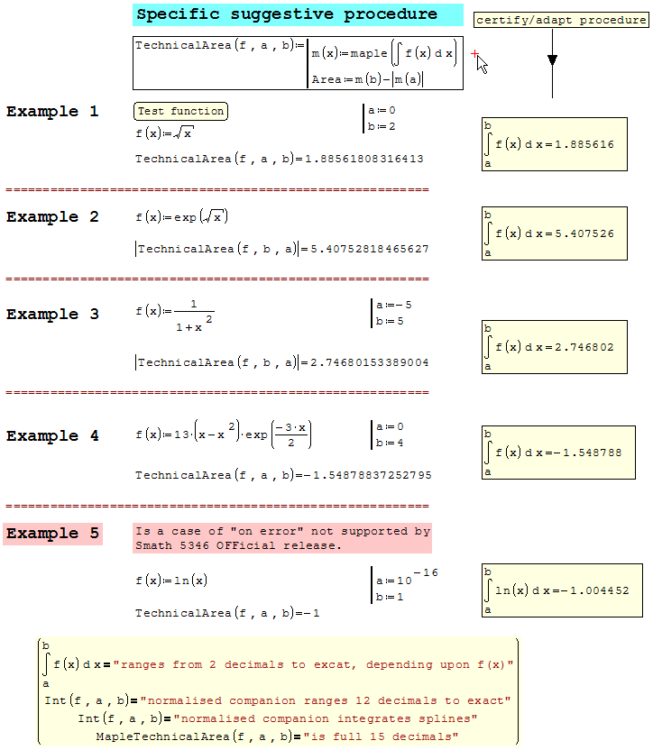

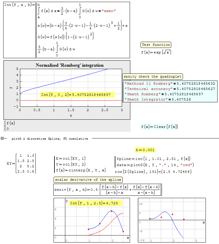

...my collaboration about "Integration" seems to end here.
There is surely a way to universalise the "Maple Procedure".
Hopefully, this Smath document answers all past & future questions.
Maple Procedure will not solve all cases, for instance: if Maple
returns a function that Smath does not have [Polylog, Bessel ...]
the Procedue will fails.
